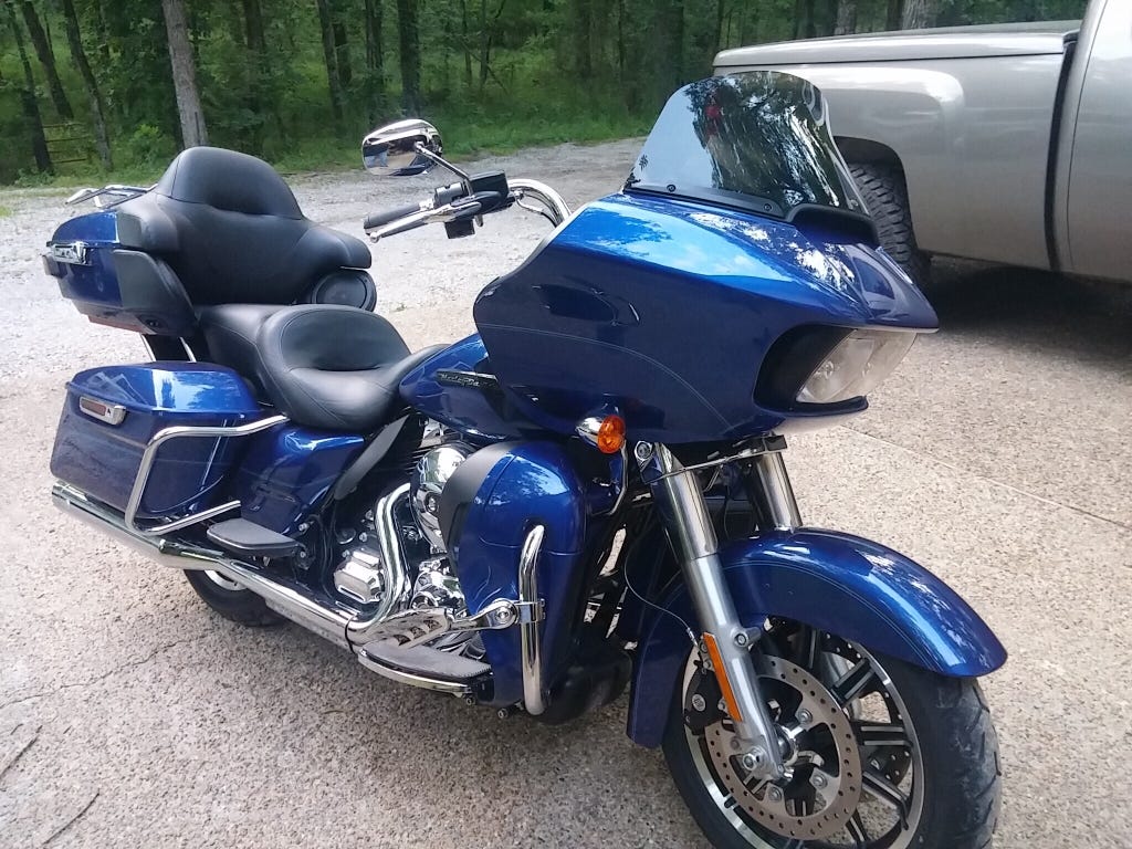

I'm considering putting the detachable setup for the tour pack on my 2016 Road Glide Ultra and going with the Road Glide Special look for local riding. If I do this I'm also thinking about putting the Street Glide Rear Fender and Fascia on it.
Does anyone know if the 2017 Street Glide Fender/Fascia setup will fit on my 2016 Road Glide Ultra?

Your definitely going to have to look into the wiring . The detachable kit comes with the saddlebag lights for turn signals (built into tour pack on ultra) and a gomer (IMO) looking plate mount. The RGS/SG fender and facia will fit, but they have the turns and brake built into the light bar. The fender, etc will fit, its in the wiring. HD parts does have a CVO style fender/light kit, that shows it will fit the 2016 Ultra, but it will require you painting and its $$$, but may have the wiring figured out for you and it looks nice!! brake/turns are built into the facia like the CVOs...
